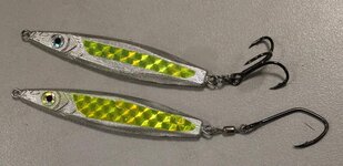

Inspired by the buzz bomb, I got myself some jigging spoon molds the other day. First tests with the new tins were promising.
Especially the flutter jig caught my attention. Under tank-testing, I noticed it would perform a nice -how should I describe it - spin-stall. Meaning it spins and breaks away when you pause the retrieve. A very sought-after feature in a far casting seatrout spoon. When I testet the 3/4 oz one today horizontally, it was grabbed by a nice 20" would-be-keeper seatrout on the 3. cast. The fish was hooked right under the rod tip, just when I tried to find out if the lure would perform this maneuver. Before I knew it, it was in the surface, went berzerk and threw the hook...
Many heavy seatrout plugs here are designed as inliners to help prevent this from happening. After a few more casts and another, barely legal seatrout being landet, I rushed back into the shop to get the dremel out:
Tank-testing proved fine, however a rather thick wire diameter is needed to get a nice spin even with a dressed hook. That again gets in the way of the eye sockets which are already almost back-to back as they are.

Cool modification and those are great looking spoons. Would think they would allow a little more room between the eye indents since it needs a wire form through it anyway.
goodtimesfishing
Nov 22, 2012
351
Arlington WA
Great idea to make them like buzz bombs.....I would recommend not using a wire. Just run your line thru the jig, then a bead(to protect knot) and then hook.....I like to use dressed hook.
I think you will find the action to be better if you don't use a wire thru the jig.
I believe the action is much more natural looking when the line is thru the jig, rather then line being tied to eye. Another benefit of line thru jig vs eye(cc wire form)is, once fish is hooked the lead is free to slide so that the fish can't use lure for leverage to twist hook out of mouth.

That´s what I am speaking about. The greased wire is only there for the casting in order to create a cavity for the line. I´ts pulled afterwards, evt. left in for powder coating. However, a larger diameter improves the lure action but interferes with the eye sockets while casting. Got me 1 gr more weight, a lot of flash and the sprue became very hard to cut of. All I am sayin is that mold-modulation should include taking off some material from the eyesockets.

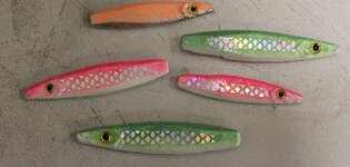

Did the other cavities today. I`m really not good with the dremel so I just made a notch into the bump that holds the eye, just enough to center the pin in it. Laid the pin into it, checked if it was in place, closed the mold and hit it whith a lumb of lead as I have learned it here. The result worked fine. I could have left it as it is and used it for both either eye- or inline pin pouring, but that would have left me with some flash every time. Wanna go commercial with this so I filled it with jb weld. Hope that will come out clean. Since I needed inlays for the filling, I poured a couple with hard lead and powder painted them. Its easy if you chose pin length accordingly and bend a hook in it so you can handle it and hang it up for curing. I like the look of tin better but want to try the whole 1oz.

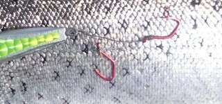

Truth to be told, the inline design isn´t really necessary. I dremeld a little space into the mold to accept a swivel and allow for the classic diamond jig setup. The result works just fine.
The spin-stop- rotation es even better than the inliner, probably due to less friction. Tank testing showed that the hook doesn´t spin with the lure, which means that the swivel helps with the spinning. Got 6 cod and a small seatrout within only 100 minutes of fishing today, without a single missed hit or lost fish. :icon14:

Tested the 1oz lead body toady surfcasting in strong onshore wind (5-6bft, gusts 9). Never seen a seatrout lure cast even remotely well under such conditions - and catch! :icon14:
24", 2,13 Kg - perfect cold smoking material!
