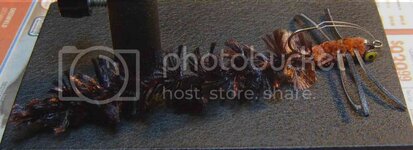

My latest bass tie. Used a new-to-me technique to make its tail with an eyelash yarn. It's called furling.
Furling is the process of twisting a section of yarn, attached to the hook shank, so that it will twist onto itself when its tag end is tied back to the shank.
Materials:
  • Spirit River Real-Eyes Plus 7/32" Dumbbell Eyes - nickel/yellow.
  • Coats & Clark Trilobal Polyester Embroidery Thread (40-wt.) - Chona Brown #51.
  • Lion Brand Suede Chenille - Canyon (discontinued).
  • Bernat Boa Yarn - Dark Mink #46913.
  • Kiwi Boot Lace - brown.
  • Eagle Claw Weedless Hook 249WA-1/0.
The tail is extremely limp and lightweight. Total lure length is approximately 5 to 6 inches.

WTF?????? :cool: That is a crazy looking critter of a jig/fly/creation! Bass will HAVE to kill that thing just in frustration of trying to understand it.
Furling - I have done some reading about using the technique to make fly line leaders, never thought to use it in tying.

Thanks FM and AF. :)
AF,
Many fly tyers furl eyelash yarns. To the best of my knowledge, a fly-tying Nun (not flying ;)) developed, of all things, a grass carp fly that began to popularize this technique using Bernat Boa Yarn. Boa is just one of many different eyelash yarns that are quite useful for tying attractive flies and jigs. Perhaps the most popular of them is the long since discontinued Bernat Disco Yarn.

Toad should learn how to do that and attach it to that weird dragon jig head!! Now that would scare the heck out of the fish!!!!!!!!!
smalljaw
Aug 25, 2012
1,442
City & State/Province
Pennsylvania
