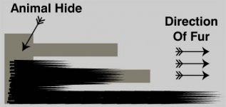

Adam - If you are confused about the cross cut vs. the straight cut zonkers, what is the difference... here is something i was working on awhile back to post up on the site but never got around to doing it. Hopefully this shows the difference in how the hair lays on the strips...
Straight Cut - These are what you want for a tail material where the hide will extend out past the hook. The hide is very soft and flexible, it moves around in the water very easily and has some excellent action.
This jig has straight cut out behind the hook and a straight cut running up the back of the jig.
Cross Cut - These are made to be wrapped around the hook shank similar to how you would wrap chenille. Just have to make sure the hair is pointing towards the back. It gives a nice full body to a jig or fly and the hair itself actually "breathes" when you give it a jigging motion, it's body expands and contracts.... very cool!!!
These jigs have both straight and cross cut zonkers. The striped fur out the back is a straight cut. The "body" fur (chart on the top jig) is a cross cut that was wrapped around the hook shank then i added in a small piece of cut from the hide fur (the black) to give it a back color.
Hope this helps.....
