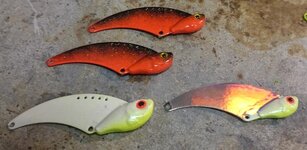

The Goby's look neat, but there isn't a Goby in the state here. I played with painting some recycled used blades a few years back, and came on a winner color combo. Smaller blade, used vertical jigging, painted pearl white, then lightly shot a chartreuse back and a tiny spot of hot pink where the bottom of the gills would be. Outfished all others 3 to one til a tree wouldn't give it back after a lot of trying. If you get bored, give it a shot while I look for the pic of this that I have.
skeetbum
Aug 26, 2010
86
City & State/Province
Debary, FL
OK, so I had it backwards but here's the pic. The wife bought me an airbrush for Christmas that year and I painted everything in sight. Hope it works as well for you as it did me. Everything in the pic turned out to work very well.
