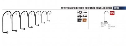

I bought some primer paint yesterday for my press frame now that the rust has been cleaned off, will try not to let it get that way again. ledhead showed a link to janns netcraft I think it was and they are carrying a mustad brand version of a sickle jighook and looks to be longer in the length, I wonder how sharp they will be. I'm tempted to try some.

Here’s the hook it comes in bronze and black buckle.

yeah Mustad did a good job too on the crappie lite jighooks which are extra thin wire and very sharp and they bend out most of the time when snagged, so I would be willing to try another mustad offering, you never know till you have it in your hand or fish it though, so much you can miss through a pic.
