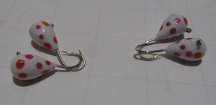

Here's how I do the dots:
Just a Bamboo skewer with the tip sanded down on an emery board.  Depending on how much you sand the tip really sets the size of your dots, although there is a little leeway, depending on how much paint you load onto the point.  Really cheap to go this way; a hundred-pack of skewers cost me $2.
And here's the Valentine tungsten jigs.  The two on the right are the Pearl White base, the two on the left are the Glow White base.  All four have a thin topcoat of Rosey's 200% Clear to seal the head.  I'm not planning on dragging bottom with these, so hopefully they stand up to Bluegill teeth with no trouble.
